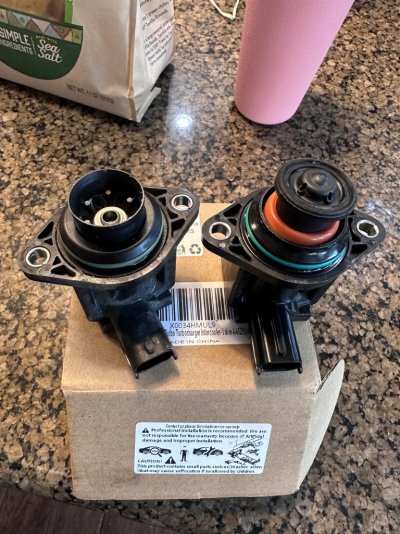

Only other oddity, which may be attributable to my heightened sense of awareness after having the engine apart twice, is when the turbo kicks in now there is a sound that almost reminds me of a static white noise machine. I’m not making too much of it (yet) since it’s not unbearably loud but definitely something that wasn’t there before.
