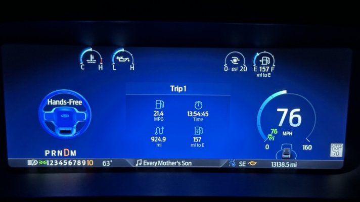

To follow up, we arrived at our destination in FL tonight. Normally we stop for one night on the road when we make this trip. With Blue Cruise, it was a more relaxing drive, and the traffic wasn't too bad. So we drove the whole 950 miles in one day. Blue Cruise was the main reason I bought the Platinum trim. After getting south of Knoxville the cruise worked perfectly. At one point a car to my right front started to drift into my lane and the cruise hit the brakes forcefully and avoided a potential accident. I was looking to my left at the time and would not have seen the car coming over in time. I'm sold on BC. Now I want the update so that the turn signal can control lane changes.

Regarding the picture on your dash...
How programmable is that display? are there different presets you can select from that will change the look of that screen? It seems pretty bland.
I rented a new Suburban a few months back and I was able to change the display and all its contents easily. Lots of different screens and info to select from. It was really slick. Also the android auto implementation with maps and stuff was excellent. I have not seen too much on the 23 plat. Android auto on the 2020 is crap - running sync 3.4.
For BlueCruise, especially in hands free mode, the 2 cameras trained on your eyes watch you very carefully to make sure you're paying attention to what's ahead of you — the dash is deliberately not busy or flashy, which would distract your attention from the road.
There are a few different screens available. I don’t think it’s as configurable as my previous Yukon.
