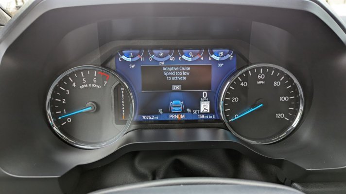

No, there is a single button that turns cruise on and sets at the same time. Pressing this button should normally not set the cruise active while at a stop. I have figured out the issue.
With speed recognition turned on in the settings, it sometimes displays an erroneous “speed” which is just a blank black box. If you hit that singular button on the steering wheel even when at a stop it will turn cruise on and set the cruise to 15 mph. When speed recognition is working correctly and you hit the same button it turns cruise on but does not set a speed, when at a stop.
Whether I accidentally hit the button or not, that is extremely dangerous. Ford has tried to put this fail safe in but there is a bug in the software that allows it to be set when at a stop. I wouldn’t accidentally hit the button probably if I didn’t have to wear gloves in the winter because the heated steering wheel does nothing.
