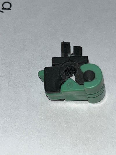

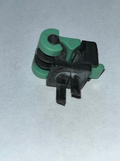

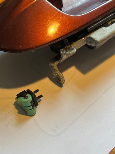

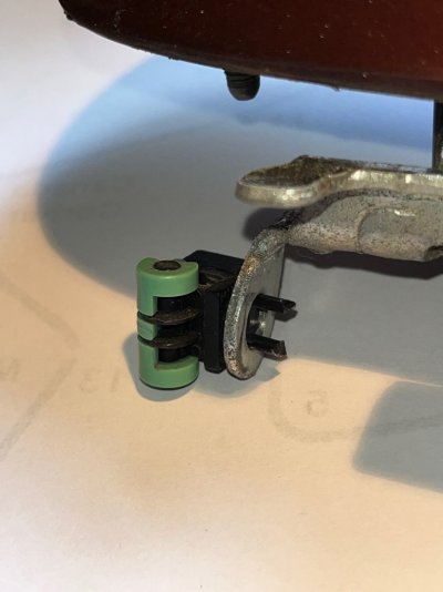

I took the door panel off and removed all the other parts that were in the way and was able to find out what the problem was with the outside handle. The plastic part that clamps around the rod that moves the lock and goes through the hole in the outside door handle was not there. I found it inside the door. It looks like it's supposed to have a pair of little ears that clip into the hold in the handle that are broken off. I'm not sure if the Ford dealer would have this part but I'm going to take a run over to the local one, just a mile or 2 away.
Here's what the parts look like: Rear Drivers Door Lock Part 3.JPGRear Drivers Door Lock Part 1.JPGRear Drivers Door Lock Part 2.JPGRear Drivers Door Lock Part 5.JPGRear Drivers Door Lock Part 4.JPG

I found the part at my local Ford dealership parts dept., they had 1 left. They are built a lot sturdier than the old one. Instead of those 2 little pins that went through the hold in the handle it's a piece the full size of the circle with 2 tabs on either side that now goes through the hole in the handle. It's all put back together and I now have 4 doors on my Expedition. Now I just have to get 4 new tires and then recondition the seats.
