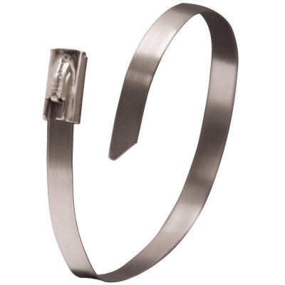

Ever heard of an aluminum zip tie? Using these you'll never encounter the issue of them drying up and breaking off

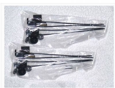

Yes I have; used plenty wrapping head pipes on Harleys; mostly Sportys. However, I used the term "zip" ties loosely. The fans are not attached with conventional zip ties but with industrial nylon strap, shock ring and locking disc that is secured by the zip tie principal.
