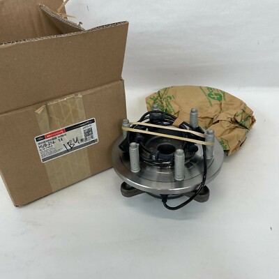

Ahh okay, I did not notice the previous note on RWD. Yeah if you're sure it's the left front it must be the wheel bearing. I still think jacking it up and testing the wheel bearing for play and rotating the tire and listening is a good start. You mentioned the noise is reduced when turning left unloading the bearing, if the noise also increases as you turn right then I'd say the wheel bearing is the culprit.
I have had much better luck the last few years with OEM parts over aftermarket. I've also found some pretty good prices when I searched for a while. I got both front Motorcraft hubs for my '04 4WD Exp for $218, but it took a good bit of time and searching:
https://www.rockauto.com/en/moreinfo.php?pk=1118184&cc=1411108&pt=1636&jsn=535
At $95 it might be worth trying the Moog, but their quality has taken a real nose dive in recent years in my opinion:
