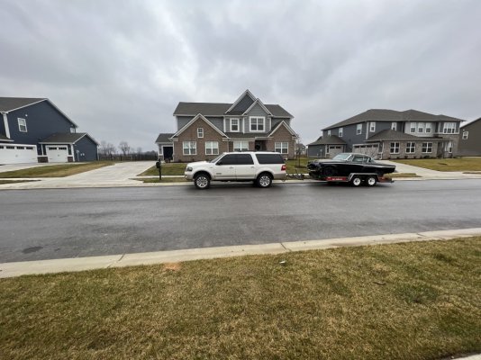

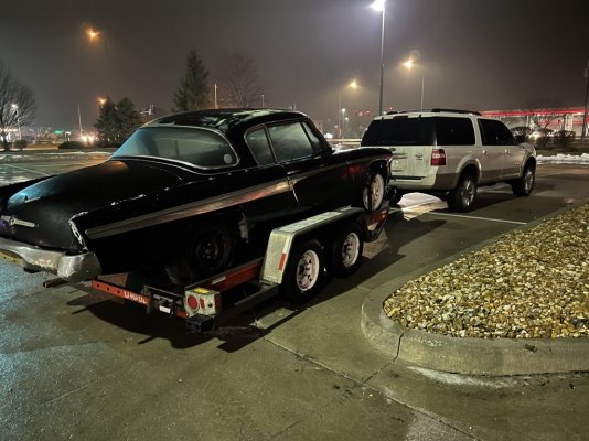

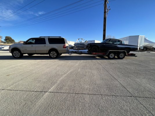

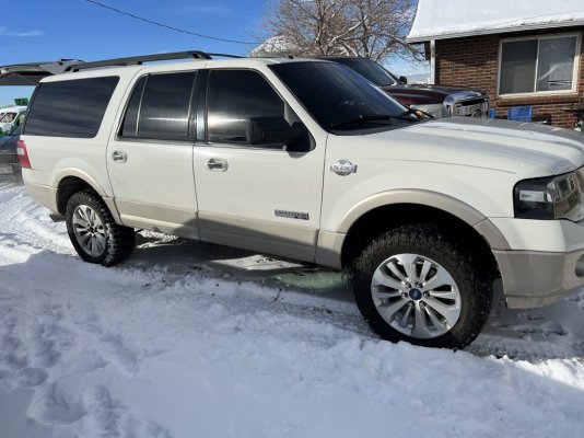

mkbruin
Dec 12, 2021
73
28
Indy
Load range F.
The ride is…. stiff.
