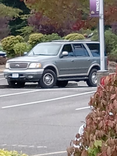

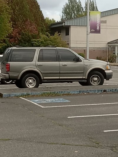

Hey ya'll 1st post about my double aught (2000) EB Expo she runs great, tows strong, 4xfun.. BUT, IM ONLY GETTING 6 TO 8 MPG it cant just be the 5 four. my old hoss 98 f 150 pulled 18 on the wide roads. Im noticing what feels like a drag tho. And sometimes turning in a parking lot it feels like 4x is engaged even though its not supposed to be. Could the bearings slow me down so much? The park brakes? It had air before and someone switched to coil springs recent but the shocks are shot, I figure thats the loud rattle i hear going over speed bumps and attribute the CK SUSP dash light to also, my scanner does not read any codes sooooo hmm.
Cant do? My normal replace em as I pull em tune up with the hollow daze lurking but i will pull the two hard plugs see what I see, saw from you gentlemen here that the Co2 sensors can do bad things but like i said no cel no codes. If anything there is a grumblegurgle while idleing on occasion. And ya know? It doesnt get very warm as far as the heater inside goes my cold blooded lover says she need a blanky when we take this beast for coffee and muddin. No sir, no anti frz smells, no sir no gasoline smells, have noticed the oil light flash twice but a half quart of oil aint the same as 6.3 mpg. Can any body heah direct me to a happier ending? We Really like the 250k mile green and gold cargo hauler and wish we could Do a newer decade or two model because well, Damn those things are saweeet cept they cost more than gas.... Fo now. Hangin tight in the soggy PNW wi
