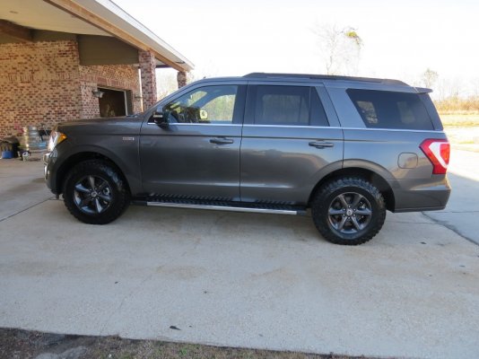

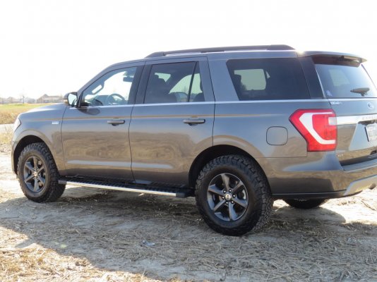

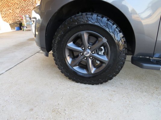

I've got a '21 FX4 which is pretty close to a Timberline . Running 275x70x18 BFG's on stock FX4 wheels. These are 33.2x11 and give ample clearance even when towing our camper. I would not go any larger at stock height. Not much height increase over the stock 275x65x18 Michelins and didn't disrupt the speedometer or 3.73 gearing too bad. Running these tires at 42 psi cold gives a fairly smooth and quiet ride. Expect a 1 to 2 mpg drop in fuel mileage but I'm still getting 17 mpg in my daily driving and 19 mpg at 70 mph on flat highways. Very pleased with these BFG's so far. I'm sure the Duratracs should be close in performance. The Falken Wildpeaks would be a good option also. IMG_6207.JPG
