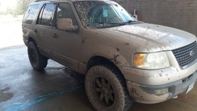

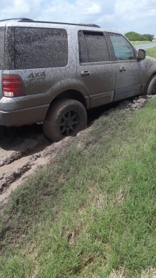

I don't not recommend anything bigger the 33in and wider then 10 depending on your offset of the wheel. I'm running on 35" with a leveling kit and the rub on hard bumps and sharp turns beside that for all-terrain tires they do good.
Jan 23, 2021
South Texas
Rims are 20" x 10" unknown offset, tires are Nitto's Grablers. Did any even trade it had some 20s ×14s wheels on 33 mudders but I didn't like them. Found out it busted one of the sway bar links. Just got new Detroit Axels links and just need to install them. Will post pics of it in the future. Here is a far pic of the 33s tires and wide wheels. Don't mind my guard.
