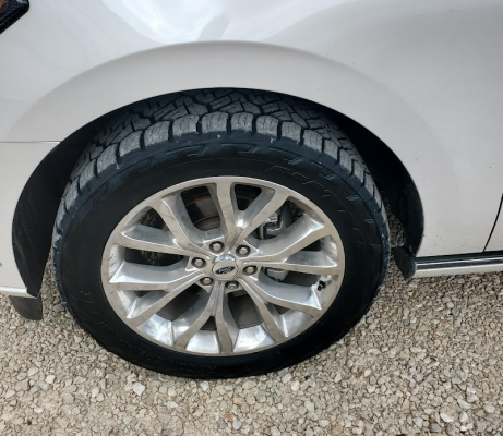

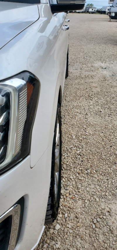

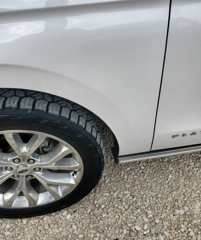

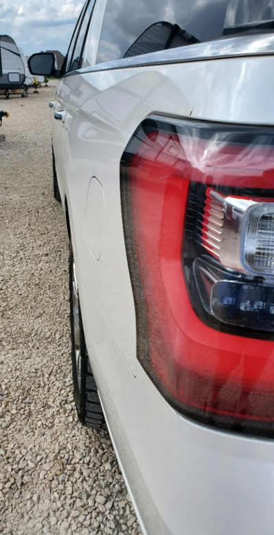

Not a 33x12.50 but I wanted this posted because I couldn’t find actual info anywhere. I just got a set of 305/45/22 Toyo AT3’s put on and I have no rubbing while driving. At complete full lock sitting still without letting go of the steering wheel the tire slightly touches the control arm, but I haven’t had it hit it while driving yet. I don’t think you can go any wider on the stock 22.

Thanks for sharing, was looking at these exact same tires and size for mine. Do you have any more pics at a 3/4 angle or down the side to show how much more they fill the 'tuck' of the stock wheels? Do they get close to rubbing the fender liner anywhere? I have mudflaps on mine so I know I'm definitely closer than stock on the front.

I’ve got these pics. They aren’t anywhere close to hitting anything on the fender liner, but I’ll try to take a picture for you soon.

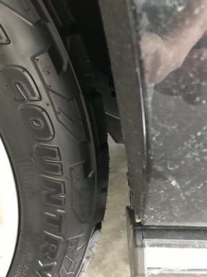

@Sunflowergirl ok I will take a pic. No rubbing at full lock. Parked or even making a u turn. I'll take a pic in a bit. Getting windows tinted now.
Sent from my SM-N950U using Tapatalk
Yeah park on a curb and turn em at full lock, replicate like you’re going off-road, they probably are good driving on pavement but offroad id bet They rub
