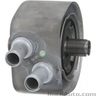

Hello guys
I have a Ford expedition Eddie bauer 98 and I need to replace the oil cooler but I don’t know how, do you have any tutorial? Or any clue that can help me out because it is mixing the coolant with the oil

Typically, on these engines, when the oil and coolant are mixing (and you're sure you don't have a cracked head), then it's usually the gasket between the oil filter housing and the block. I had to change mine on my 99 right after I bought it. It wasn't fun, but it's not the worst job I've had. There are multiple YouTube videos on it.
