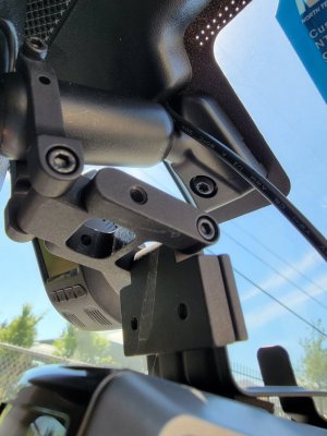

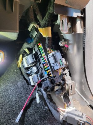

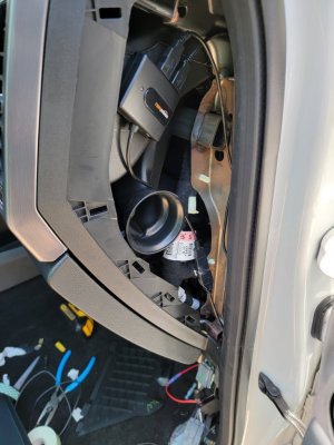

So there have been a couple other posts about this but I wanted to share what I came up with and what worked for me.
First off my radar detector is weird, it uses 5v power instead of 12v. My dash cam also uses 5v. So I did not want to use the mirror power tap method because I would need to mount the 12v to 5v converter up there as well.
I ran both cables all the way to the passenger side fuse box using a fuse tap on fuse 37 (steering wheel heater). There have been reports in the previous posts that the steering wheel heater would stop working using this method. Mine did not have this issue and I was able to find fuse taps that actually fit securely without modifying or cutting the fuse box area.
Only issue I have so far is finding a usb y cable that supplies power. The one I bought doesn't pass power on either port.
Here are some pics. Second one is just showing there is room without modifying the cover to run the wire.

That was me that lost the wheel heat. I was told by some techs on another board it is pulling too many amps and the computer is cutting power on that circuit. They said I should be able to get it reprogrammed to allow a bit more to flow. With the pandemic I have driven so much less that I forgot this was even an issue. So haven’t pursued anything further.
if I’m reading that right, you’ve not yet tried to use both things at once? Hopefully you are under the cutoff. I’m kinda not seeing the point of a fuse to protect the circuit if the computer does it automatically, but that appears to be the case.

To solve the drawing too much current from the wheel heater...us professional installers use a relay to switch the power and a fuse tap on an ignition switched fuse. I personally like to tap into the same circuit that switches the entertainment system so you still get delayed power until the door is opened or the timer runs out. Choose the 5v power supply carefully, quite a few interfere with the FM radio reception on distant stations.
