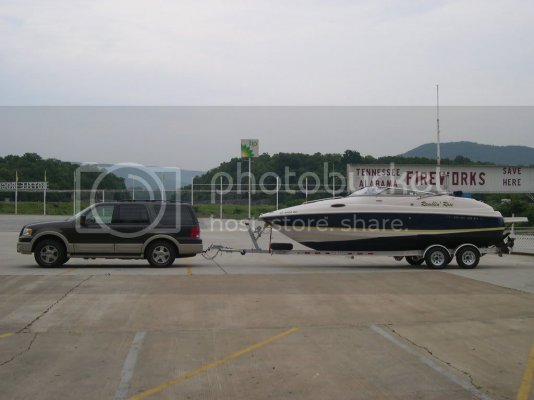

As seen in the pic above, the Expy sat about 3 inches, but rode pretty well. The trailer dealer said it would be wise to invest in some air shocks if I was going to be pulling the boat frequently.

You have some serious squat from the photos and are consequently unloading the front axle. You need a WDH. Adding air shocks or rubber thingies will make the truck tow level but the weight is still being put on the rear axle and taken off the front.
Here's what 5000 pounds of trailer should look like. Equal suspension compression fore and aft:
What's your tongue weight? Ours is pushing 700 pounds.

Thanks for the pic. Yeah, that does look better. The dealer's main business is trailer repair, and he sells new trailers on the side. It was the cheapest place we could find the trailer we got by a pretty good margin. Exact same trailer somewhere else was at least $1500 more. So it doesn't surprise me he may not know what he is talking about. I would think he would want to sell me a WDH by any means, even if I did not need it, but he said it wasn't necessary. I will be pulling the boat every other weekend in the summer months so I will probably invest in one.
