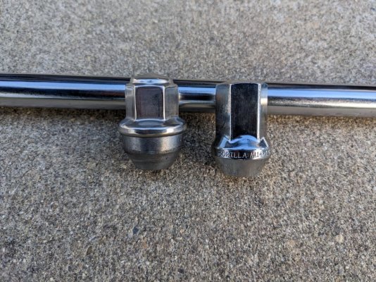

The ford lug nuts have a stainless (?) tight fitting covering over the lug nut. Except it is not that tight. Moisture and salt get under it which then corrodes the nut like crazy, causing the stainless outer to swell up. You then have problems. First getting a lug wrench/socket on the nut, and even if you do, the excessive corrosion can cause the nut to just round off under the cap.

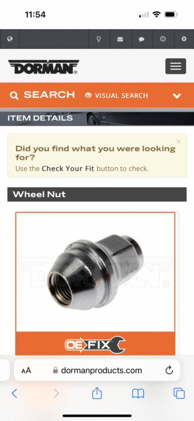

I had the Ford dealer install solid Dorman lug nuts on 2012 XLT model with stock aluminum wheels. They are a perfect fit and holding up well.

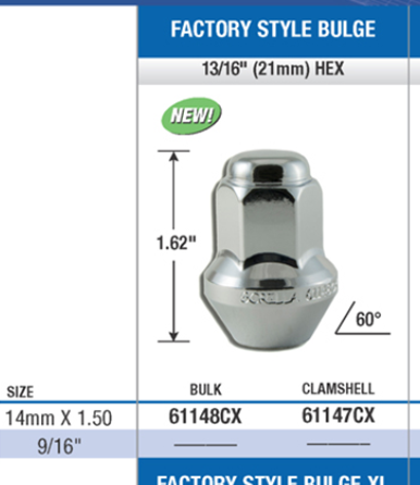

Recommend the Gorilla solid aftermarket lug nuts as they have the correct length 60 degree seat, are the correct overall length. correct color, etc. The Gorillas are often about $50-60 for 24 on eBay. The Gorillas held the 150 ft/lbs torque spec on the first go--- an early McGard from Summit Racing (the available model then had a too short 60 degree seat) set had to be rechecked 2-3 times. My 2015 Expedition 4X4 got new full sets at 11 and 34K under basic Ford factory warranty. Wonder about $50 Ford dealer lug nuts as they can easily run $11-13 per each times 24, plus sales tax--often push $300 out of a Ford parts window here in Tennessee. My first set of regular chrome solid Gorilla's have begun to have superficial rust after about 55K that I suspect will polish off easily enough--otherwise full performance. Still unclear the cause of such early Ford lug nut failure--for sure rust did not happen in 11K. Besides the Ford cheapo design, the culprits seem to be the impact wrenches and heat from the brake rotors. Even the class action lawsuits on the subject don't seem to pin down exact cause(s)? Have owned six new Expeditions. (BTW, had a personal email from a Gorilla national sales manager on this subject--very helpful getting the correct model for my 15 Expedition.)
