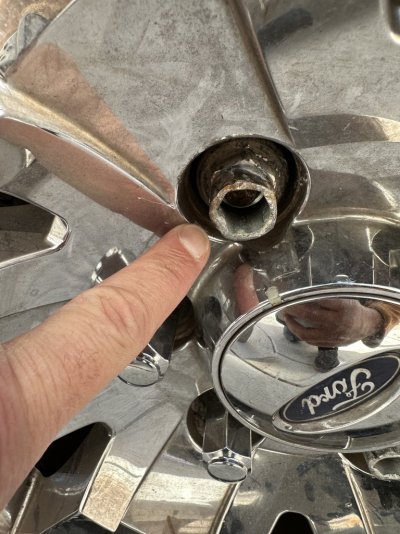

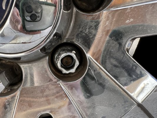

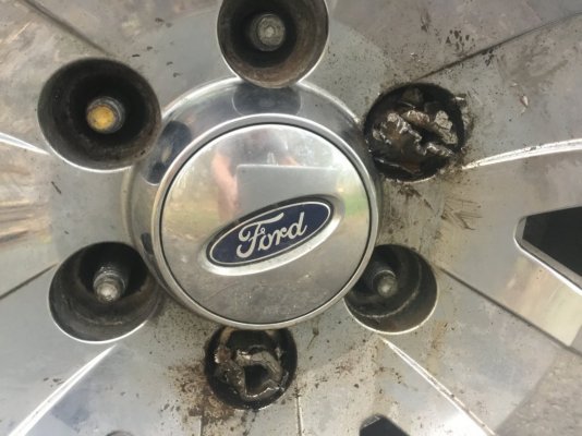

I have a 2010 EB and ran into the dreaded lug nut issue. I recently went to get my tires rotated and balanced and the quick shop guy couldn’t get the rear passenger side tire off. So I did some research here on the forum and went ahead and ordered a set of the gorilla lugs. I brought the truck to Goodyear figuring a “tire shop” would be equipped to handle this and much to my disappointment they were able to get 22 of 24 lugs off and replaced.
So based on the pics, I’m trying to understand what I can try. I’ve seen vids that showed drilling them out through the stud, and others using a torch but the rims will not hold up to that. Has anyone had any luck with these stripped nut extractors? At first glance they don’t look like they’ll fit over the nuts.

The outer caps for the two nuts are gone, what you’re seeing in the pic are the severely gnarled inner bolts of the OEM nut. It appears they tried to “hammer on” undersized sockets with no luck leaving not much to work with. That’s why I’m questioning if there are any specific stripped nut remover sockets that would be able to fit over these and still have clearance for the socket holes in the rim.
