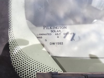

Looks like your windshield gasket is worn out. But also make sure the drain channel that runs down the side gasket is clear of debris, especially at the bottom, so water doesn't sit in the gasket channel. If you park under trees a lot you'll find the channel gets clogged fairly routinely. If the gasket is in obvious bad condition (i.e. dry rotted and torn...) Take the Expy to a automobile glass shop and see if they can replace the gasket and save the windshield.

Looks like your windshield gasket is worn out. But also make sure the drain channel tht runs down the side gasket is clear of debris, especially at the bottom, so water doesn't sit in the gasket channel. If you park under trees a lot you'll find the channel gets clogged fairly routinely. If the gasket is in obvious bad condition (i.e. dry rotted and torn...) Take the Expy to a automobile glass shop and see if they can replace the gasket and save the windshield.

Yeah I've never had to replace a windshield before so wasn't sure if they are one-time installs or can be reinstalled again and again. If i do need to replace the windshield, does anyone have any advice on glass brands for Ford vehicles? Obviously OEM would be a sure bet -- but I'll take a decently priced alternative if needed (my dumb money-tree didn't bloom this year....). I'll check the drain channel in the morning.
