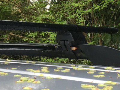

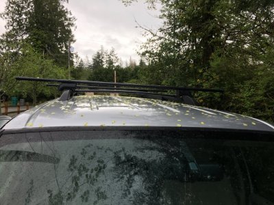

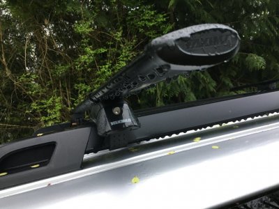

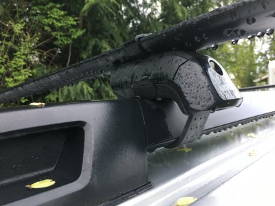

The Timberline Towers fit the factory rails but they might not adapt to a round bar. I have the 70” corebar aerodynamic cross bars on mine. I ended up inserting pieces of wood in the rails to prevent them from being crushed by the towers when tightening them down. They ended up strong, sturdy, and quiet.DBABB2CF-E223-4E3D-BE91-22746795DBA0.jpeg 9D3DDA1C-76EA-41F4-B117-8A903B8EB494.jpeg D2AA1664-5561-4709-8F61-4629C137C63E.jpeg 6CEEBBF4-29F1-4E9F-886F-B61A89BA5D4D.jpeg BD302EE6-326F-4E65-96A4-A609884581C1.jpeg
