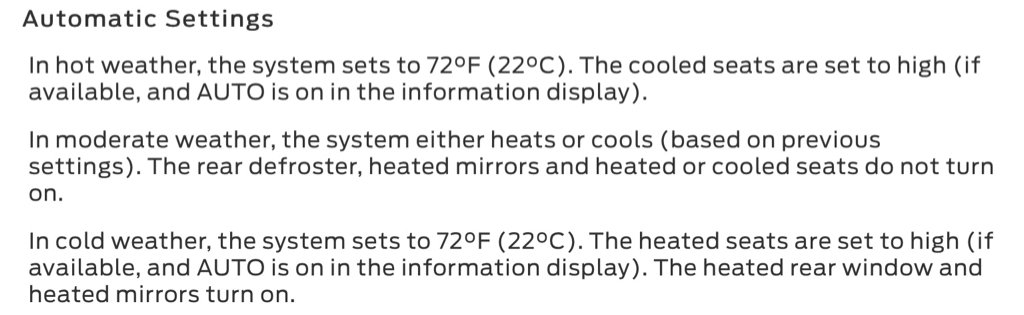

Here’s the bit from the manual:

No, the lights don’t come on until you press the start button (with the key inside).

I stand corrected. Thanks for setting me straight, Shane.
