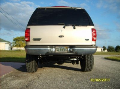

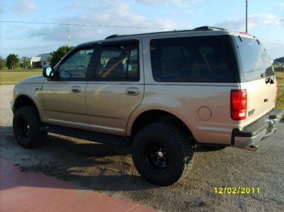

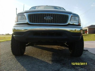

Well I got the lift installed today. Took me about 3.5 hrs to complete it. Looks pretty good, and I achieved 2" in the front and 2" in the rear. I could of gone more on the front, but I will need to get longer new shocks. I took it for a test drive, and I can say that I will be buying new shocks as it is a bit bouncey in the front due to the shocks almost maxed out. So that wil be next. The rims will be in on Tuesday, and Wednesday I get the dual exhaust installed. It is coming together pretty good and rapid.
Tell me what you think,
Before lift,
After

That holds true for all IFS. Angles are a very important factor to take in consideration when doing a TT. That is why I only went 1.5" in ht up front, even though the indexed keys can gain you 3" if desired. And not only that, but the shocks can also max out and causes a very bouncey ride limited from itself constantly. I am still going to buy new 1-2" longer travel shocks for this setup. I will eventually buy a full suspension setup once I get more involved in this vehicle. Or at that, may do a SAS up front with a D60 as there is plenty of room under there to accommodate a SAS. But time will tell, and my overall liking for the Ex. Even at 1.5" TT, it is alittle bouncey as it is now. Before I started the lift, I had 37.5"s from ground to edge of center fender up front, after the TT, I was at 39"s, that is a net of 1.5"s. Which should be plenty for the 305/70/16's going on tomorrow or Wednesday.

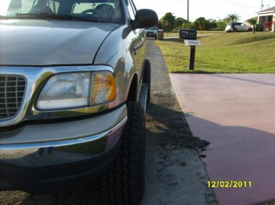

Well I got the tires mounted on the rims. But when I went to mount the tires on the front, the rims are laying against the calipers and that is not good. So I oredered a set of billett 1" spacers to mount on the rotor to bring them out enough to clear the calipers. Should have the set of 4 spacers by Weds of next week. UGGHH!

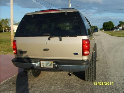

Here are some pics of the door moldings taken off and waxed and the new black pinstriping. I am not a fan of pinstriping but I took the brown stripes off and thought it took away from the body line seperation. So I got some black stripes and added them and they look great. They will also go with the black rims going on this week. I also took a few of the new Rancho shocks and tail pipes.

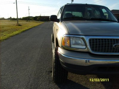

And here is the tires mounted on the rims. Also got the frontend aligned on Wed.
