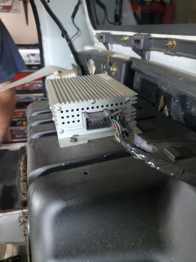

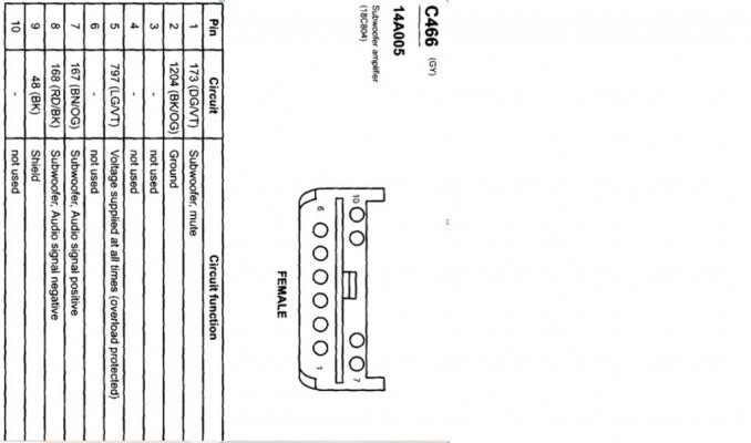

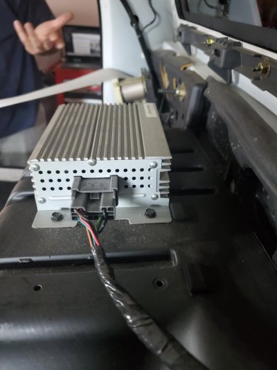

From the other conversation here's the pics.

I ran to the home improvement store tonight and the sub seems to work better when I'm slowing or stopped, like inverted speed sensitive sound adjustment (the wife's 2016 increases sound with speed to compensate for road noise). Makes me think loose connection where the weight of wire harness is just enough to make a difference in connection. No bump or popping noise today like yesterday. Adjusting fade front or back didn't make a noticeable difference; neither does using the adjustment for driver seat / all seats / rear seats.

Is it working better or is it just that you have so much more noise to drown out while rolling down the road the sub simply can't keep up? Either way my thought is that the head unit is okay since it's sending the signal. It could be a wire, but I'm thinking it's either a connection with the subwoofer or the amp is failing.
