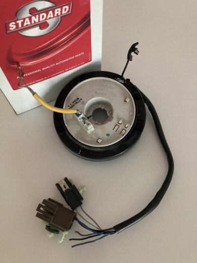

Thanks for replying. I already tried different ruise control buttons off of my econoline van and nothing. I also swapped the clockspring yesterday and still not working. By the way I had a really hard time connecting the new brown switch off of the new clockspring. The only other thing that I can think of after watching so many videos is that the servo is the issue. By the way I am not a auto mechanic. I am a carpenter or at least that is what they say. I have put a lot of time, money, and energy into this truck. Although I feel like giving up, I’m not going to. By the way , I tried the switch test but get no response. And the horn does honk when I press the on button and the coast button at the same time. It did that before I changed the clockspring and continues to do so now after replacing it. Is there a fuse in the box under the hood that I could check? And what and where is the control module?
