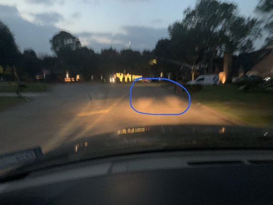

Replacement headlight assembly. 2003 Expedition I purchased the DWVO brand from Amazon. They look nice on the SUV but the light beam is horrible. See the circled spot on pic. The beams does not fill the area. It’s concentrated in two areas no matter how they are adjusted. Makes for bad driving conditions on really dark roads. Anyone had this problem before with replacements. Any suggestions on a quality replacement at a reasonable price B8029B69-AA01-45BD-AF26-05162D22462A.jpeg replacement at a reasonable price.

LED bulbs and LED projectors in the fog lamps might help a lot

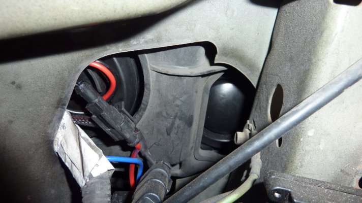

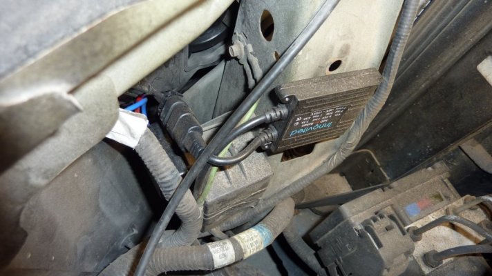

Hamfisted- Where do you have the electronics for the HIDs mounted? Do the HIDs generate a lot of heat?
They're mounted nearby ( just 3M double sided taped...) , but outside the headlight housing. You have to cut a pass-through hole and use the included grommet to pass wires through the rubber housing cap. I don't notice any heat ( other than ambient heat...), and I can keep my hand on the ballast when they're on.
