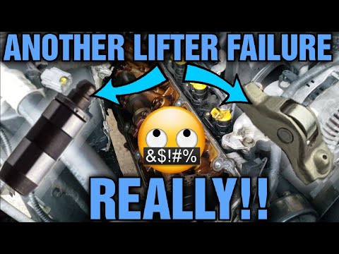

Well you have a 5.4L 3v and on my 2003 F150 5.4L 2v, that clicking sound is from the rocker arms, a common fail place for the 5.4L. This should help:

Here's my experience. Mine was bad rocker arm(s) and cam on the passenger side.

Thank you for the replies. I heard about faulty rocker arms, but at this moment I hope it is something else. I'm also not sure if faulty rocker arms would set camshaft position sensor code. Tomorrow I'll try to change the oil with the original Motorcraft filter, I'll see if it helps with ticking noise.
