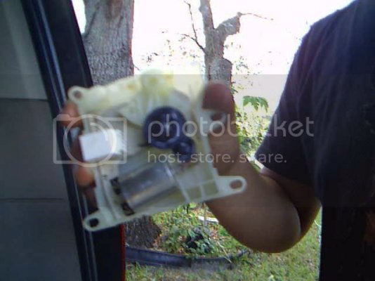

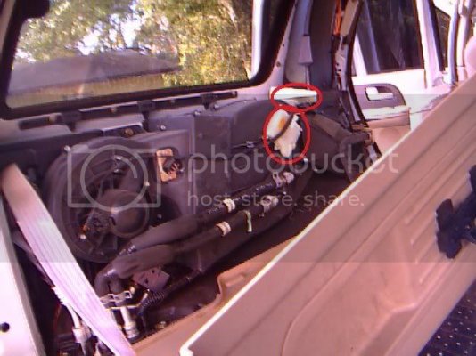

Bajaoutlaw
Oct 28, 2008
Southern California
I just bought the motor for the temp control for the rear air of my '04. 45 minutes to remove the pass. side rear plastic and replace. All is well with the noise and function, $75 later.

Any pointers on how to remove the rear plastic panel?
truk4u
Dec 14, 2008
I have the same problem and have unplugged the motor by removing the drink holder tray on top. Can anyone tell be how to get the plastic parts off without breaking anything? Are they just plastic pins or do they have a certain way to be removed.
