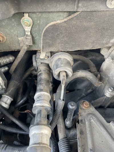

So today I was digging around the engine bay, and unplugged what I assume to be the fuel regulator (little black canister on the passenger side of motor above and to the left of the fuel rail, one single vacuum hose plugged into the front.) I took it to Taco Bell and it seemed like it had 10x the power, it threw my 150lb subwoofer box back about 2 feet threw me into the seat (relatively speaking) and revved to about 4200 rpm. Not making as much power as it should, but made power all the way there. However, it continued to accelerate with my foot off the gas pedal so I had to pull over and see what’s wrong and plug it back in. The power was instantly gone again. Also, when I replaced the fuel filter I noticed that it didn’t seem to be overwhelmingly pressurized. It dribbled at best. I’m not quite convinced it’s a fuel pump because I’m not throwing any lean codes(or any codes at all) and it sounds consistent when I turn the key forward.

Get a fuel pressure gauge and see what kind of fuel pressure you’re actually getting at the rail. You should see 45-55 psi. See if there’s any pending codes. Then take a look at live data when this condition is occurring and note the fuel trims. Post a picture of the thing under the hood that you were unplugging. Fix your charging issue. I suspect it's in limp mode.

So you unplugged your hot water control valve, and it ran 10x better ? It's in limp mode.
Fix your battery/charging issue, then maybe go get a fuel pressure test kit…..
