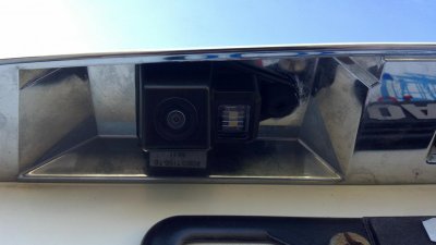

quick update, camera came in and WOW, this thing is pretty awesome! Looking at the camera and the light bulb assembly, this thing is definitely a direct fit.
Here are some pics of the camera and side by side comparison with the license plate light bulb cover:
My dog managed to grab the license plate bulb cover from our counter top and chewed it up a little ha.
Definitely a nice construction and quality camera with an OEM look and built in gridlines. I'll take some pics once it's installed, but this thing is so small and sleek! I love it.

Damn dude looks like u struck gold! It looks good
