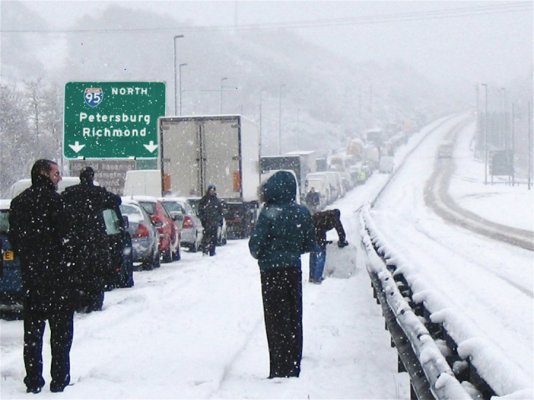

Snow can hit any-where and no-where. And it's not constant even in Colorado. Read the road signs in the photo below. And, no, I don't have show tires here in Richmond nor did I in the snow belts (lake effect) of OH or NY.
