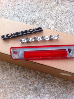

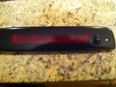

I'll share an exploded view of mine incase anyone has trouble visualizing what you describe. I went one step further and body color painted the red lens leaving the roughly 1X6 strip where the light emits.

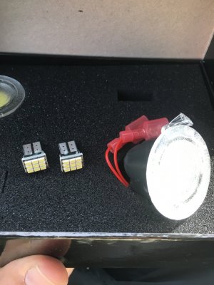

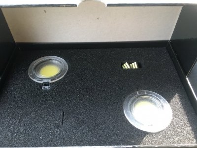

I used these for the puddle lights on the 17. http://drivebright.com/home/shop/v4-extreme-led-puddle-light-pack-brightest/ They are super bright.
I used these for my LED 3rd Brake light.
https://www.amazon.com/gp/product/B019NOSKYQ/ref=oh_aui_detailpage_o07_s00?ie=UTF8&psc=1
Both work great.

That looks nice. I would love to find matching paint and paint mine.
