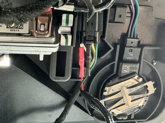

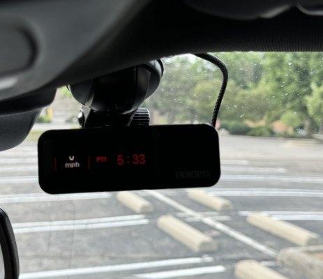

Just got another new Expedition Limited Stealth today in Dark Matter, the layout of the cover is different but wanted to share just in case others need info, it was easy using my same mirror tap, black with black and red with white, took my 60 seconds and it does turn off with ignition too.IMG_1947.JPEGIMG_1943.JPEGIMG_1950.JPEGIMG_1948.jpg
