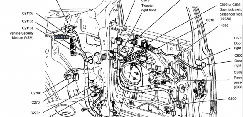

If I had to guess I'd say the Vehicle Security Module is faulty. Assuming it's in the same location as my '04 model since both are Gen2 it's on the passenger side up front.
