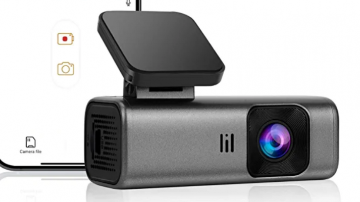

Good idea. Where did you mount the charger? Mine's pretty bulky.
G
getdealtwith
Jan 29, 2020
111
19
US
A 4K cam off of Amazon (Galphi). I bought a separate hardwiring kit for it that comes with a pretty bulky charger.
