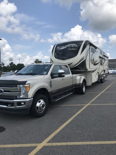

I'd say it depends on the type of trailer. I tow a 7,800lb travel trailer with an Expy Max w/max tow. The EcoBoost has plenty of power to move that much weight, but the height and length of the trailer cause the vehicle to get pushed around by the wind more than I'd like. I'm also just under the payload and rear axle limits, so I've gone to the scale several times to make sure the weight distribution hitch is dialed in.
Wife likes a Cougar 25 RDS that's close to 30' long and grosses out at over 8K pounds. Its supposed to be 1/2 ton towable but we all know how that goes. I don't know if my Expedition could handle it on our terrible roads in Louisiana. Our previous camper was a 41' Solitude 5th wheel and pulled by a '17 F350 dually. Camper was totaled in hurricane Ida and I sold my dually and bought the Expedition with no intentions of getting another camper. Wife misses camping with our friends so hopefully I can change her mind. Prices are too high on RV's and getting about 8 mpg on the hwy with the Expy with its 23 gallon tank doesn't thrill me. Miss our 5th wheel and dually even more!!
