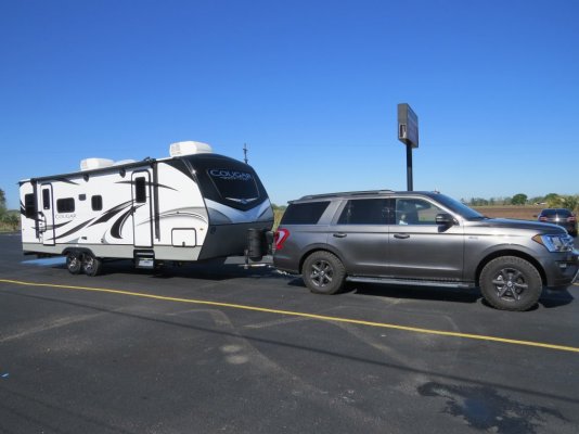

Nice floorplan for couples and one grandkid at a time! Our 2 daughters have their own campers if they want to go camping! Keystone Cougar 25 RDS and its pretty impressive for whats marketed as a half ton towable.
