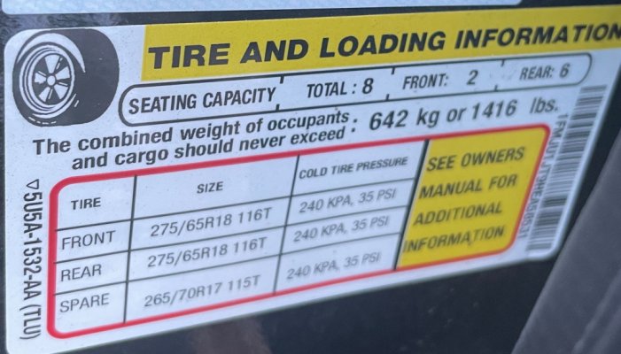

My axle ratings are 3550lb front and 4380lb rear. With just me in it my Expy weighs 3100lb front and 3160lb rear. The max tongue weight is 900lb, and with a weight distribution hitch some of that gets sent to the front so not all of it sits on the rear axle. If your weight distribution is dialed in properly, you could still have some passenger and cargo weight and stay under the axle limits.
My payload limit is 1644lb, so a 900lb tongue weight leaves 744lb for people and stuff. I add more weight distribution to stay under the rear axle limit, but I'm able to stay under all of the limits with our trailer and 5 passengers.
So one thing to keep in mind is that tongue weight doesn't necessarily mean you've subtracted that amount from your available payload. There's still the rear axle weight rating and don't forget, the tongue weight applied a levered force on the rear axle weight rating.
So it's not always the case where a 1000lbs tongue weight means you've used up 1000lbs of rear axle weight capacity.
But you've gone to the scale so that's as gospel as you can get. You're pretty much doing it the best way possible and I would trust the scale more than estimations.
