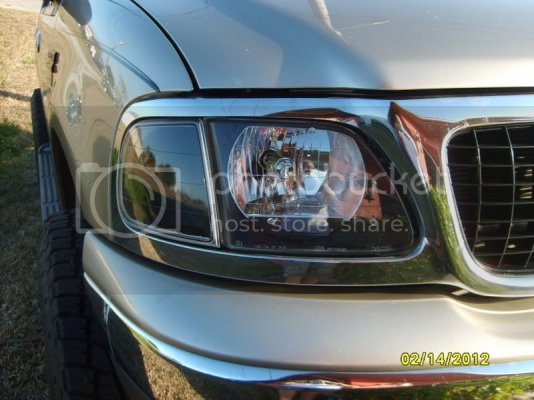

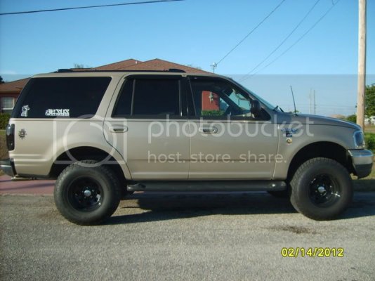

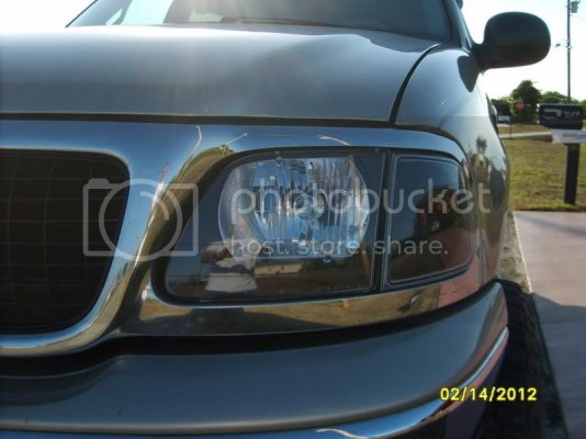

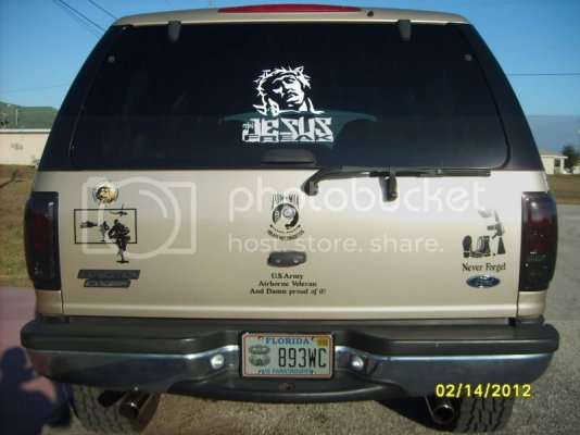

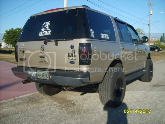

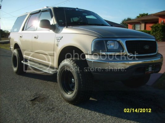

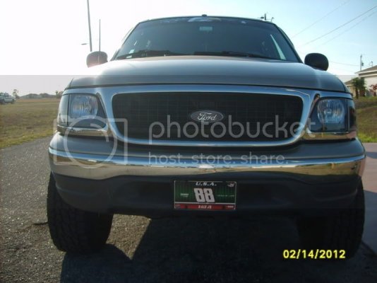

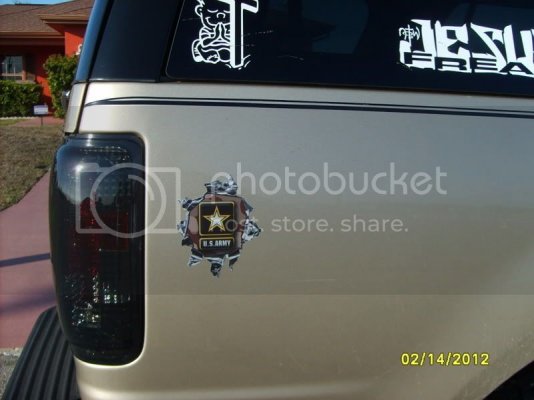

Well I did get the new smoked tail lights in and installed. I think they look great and am getting 1 step closer to all blacked out. And a daylight pic of the painted black center section of the grille.
Here are some pics,

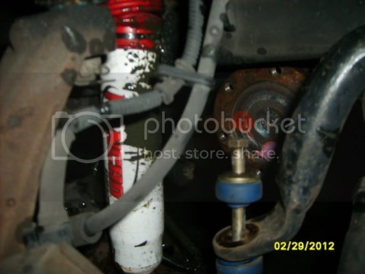

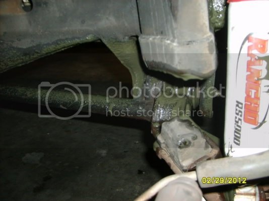

so you got shocks for a 4 inch lift? how are they i am about to do a 2in lift and i need new shocks anyway

Yes, the shocks are for 4" lift, Rancho RS5000 series. They work great and are firm. I have plenty of up travel and that was what I was concerned with initially. Since I did not lift a full 4"s, I was thinking that the shock would not have suitable uptravel. But they do and they work out great with the 3/2 lift I did. I did not use the full 3" up front. I only lifted 1.5"s total up front to keep my front axle shafts at a resonable angle without binding and premature wear.
